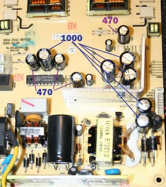

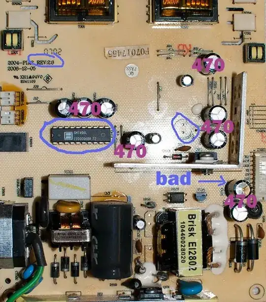

I have a bad capacitor on this LCD power board. I have rev 2.6, and I noticed there is a rev 2.8 board that looks like it didn't get skimped on in parts. Can I install capacitors in my rev 2.6 board as they are used in the 2.8?
My board:
x20wg-1080p rev 2.6
9 x 470μF, 1 x 100μF, 1 x 22μF, 1 x 10μF
Here's the rev 2.8:
x20wg-1080p rev 2.8
6 x 1000μF, 4 x 470μF, 1 x 100μF, 1 x 22μF 1 x 10μF
The differences are circled in blue. My board seems to use lower rated capacitors, is missing one, and the microchip looks slightly different. The pictures are of the entire boards.

The IC that you are pointing out is a 3W (or maybe a 2x 2W) stereo audio power amp.
The one in rev 2.6 is a SM7496L, which I am having a hard time finding any info about, but it is essentially the same thing as rev 2.8 just a different manufacture, so it is probably safe to assume that circuit should be the same around them. This means it should be safe to put a larger capacitance value on it.
For the group of 3 with one missing, it looks like these are next to something that is probably a voltage regulator with a big heat-sink on it. If this is the case, go read the answers for this question Capacitor Sizes for 7805 Regulator
For the other 2 capacitors, these look like they could either be used with the 2 diodes or could also be for the voltage regulator.

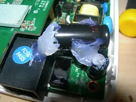

I submit the following image. I installed a 1500µF 6.3V motherboard grade cap into a product requiring a 1000µF 6.3V cap. It was too big, so I mounted it horizontally :D, adding hot glue to secure it down.
It works fine.
The product in question is an Advent power line ethernet adapter. I was given a pack of two. The first one died after 3 months and the second one after 5 months, which is ridiculously poor. In both cases, the exact same cap died. The products were new in the box but had been sitting around for about 6 months. Both are now repaired with new caps, and are working great.

    Just because it worked in your application doesn't mean it will work in his. Using this blog post as reference, you are just telling them to "press the green button". Just because pressing the green button might fix the issue doesn't make it a great answer. – Kellenjb Jun 23 '11 at 19:24
    @Kellenjb Of course; I didn't say that it would work in his, but I showed for a power supply it is plausible. – Thomas O Jun 23 '11 at 20:11
