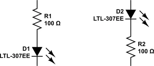

Resistors in series with other components are, themselves, transitive. They can be swapped with other components in the uninterrupted series and they will react the same. However, the other components may not like being swapped.
From the resistor's point of view, the current is the same regardless of the position. Since the LED is a current device, it won't be affected by the swap.
If you "tap" the connection between the resistor and the LED, though, then you are sure to get a different voltage depending on the position of the resistor relative to the LED - this is no longer an uninterrupted series circuit, but has some parallel aspects. In this case you can't necessarily swap them without affecting the circuit - specifically the voltage at the tap and the new parallel circuit created by that tap.
schematic
The above two circuits will operate the same in every use case you will run into as a programmer.
schematic
simulate this circuit
The above two circuits will be different depending on where that wire goes off to the side.
You can apply the same principle to many other two terminal devices next to resistors as long as you observe polarity when doing the swap. If there is no wire coming off between two items in series, then swapping the two is likely to have little effect on the overall circuit.
