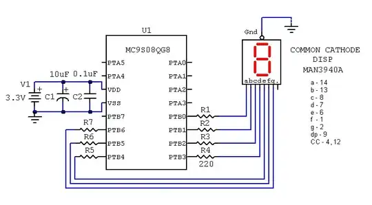

That said, in some cases the resistor needs to go between the power supply and LED (such as common cathode displays): enter image description here

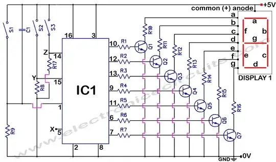

And in others between the LED and ground (such as common anode displays): enter image description here
But these are examples where the design (arrangement of LEDs) dictates the placement.
