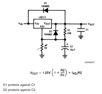

In the below circuit, the diodes protect the LM317 against both of the caps discharging into the IC when input or output is shorted. LM317 is itself capable of having it's output shorted without damage. But the input-output voltage difference must not exceed 40V. In my circuit, I'm applying 45V to the input, and getting 30V from the output. In normal conditions this means a 15V difference over the IC and everything is fine, but if the output gets shorted somehow (maybe because of the initial charging of large capacitors connected to the output), I get a full 45V above the IC and this is enough to damage it according to datasheet (it's above the 40V maximum).
What can I do to prevent this, without using another IC like LM317HV?

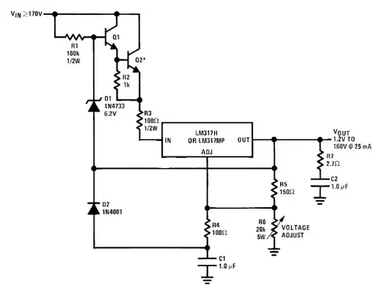

When using a voltage regulator like this in an elevated voltage configuration the output capacitor charging issue will always present this momentary issue of over stress of the voltage across the regulator. In your particular case the solution to the 45V across the regulator would take extra components and circuit additions that may very well add up to the cost of using the higher voltage rated regulator in the first place.
If you need to use the lower voltage rated LM317 then you could add a circuit similar to the following. This design keeps the input to output differential of the LM317 to less than the zener voltage.
The above circuit comes from this TI application note which you can access for more information.

  • This is a nice variant on my suggestion. Instead of blowing a fuse, Q2 and R3 dissipate power. Note that for the zener diode shown, some change to the value of R3 is needed, if output current over 30mA is required. –  Jan 09 '15 at 13:32
  • But here Q2 needs to dissipate too much additional power all the time and will need a heatsink, if I understand correctly. – downthewire Jan 09 '15 at 14:36
  • Actually the power in Q2 may be a benefit to you as it takes some of the power burden off the LM317. They are in series after all. – Michael Karas Jan 09 '15 at 14:40
  • Also if the input to output differential is less than the Zener voltage the Darlington transistor pair would be saturated to around a 1V drop across the Q2. Only when the Zener starts to clamp does the voltage across the Q2 start to rise. So in your case of trying to solve the problem of charging the output capacitor you would have have the increased drop on Q2 whilst the cap was charging. – Michael Karas Jan 09 '15 at 14:47
  • You're right about that, but I don't see any benefits of using this over the zener solution. – downthewire Jan 09 '15 at 20:27
  • @downthewire: the difference between this transistor-based Zener "multiplier" and the single Zener in the other answer (and/or in the LM317L datasheet) is that this more elaborate solution can sustain the short circuit current, assuming proper heatsinking of Q2, whereas the former (single Zener) solution just relies on blowing a fuse. Choosing the right circuit depends what want the circuit to do in case of an output short. – the gods from engineering Sep 03 '15 at 06:06
