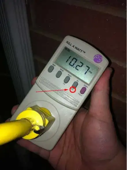

A much cheaper option (accuracy might be open to question) would be to use one of the ubiquitous "Kill a Watt" consumer products (as, I think, @ tgun926 suggested), which actually have a PF indication. The specifications are somewhere between sketchy and non-existent. "0.2% Accuracy" (of what?), but the price is right at less than $20 street price.

How do these watt meters measure real and apparent power, though? (cf. my question here). – Geremia Apr 14 '15 at 16:45
The Kill A Watt measures current and voltage samples and can calculate the in-phase product and product of magnitudes in firmware. Electromechanical wattmeters measure real power by using two coils (one for volts & one for amperes) so that the meter deflection is proportional to real power. – Spehro Pefhany Apr 14 '15 at 17:48
