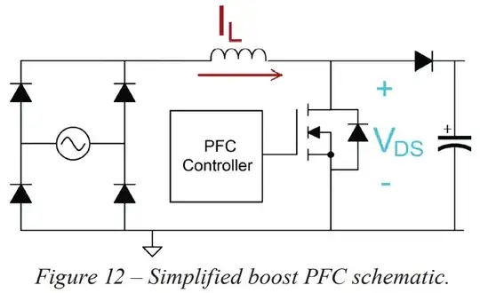

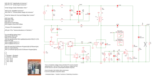

Figure 12 - Simplified Boost PFC Schematic

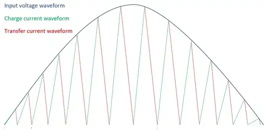

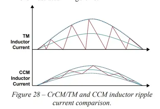

I saw this figure that shows inductor ripple current, so I think maybe this could be what it looks like (almost like a boost converter ripple current that follows the sinusoidal arc of the input voltage.) It is also unclear to me how the voltage gets boosted as well - maybe if I had a good simulation to look at I could understand better.

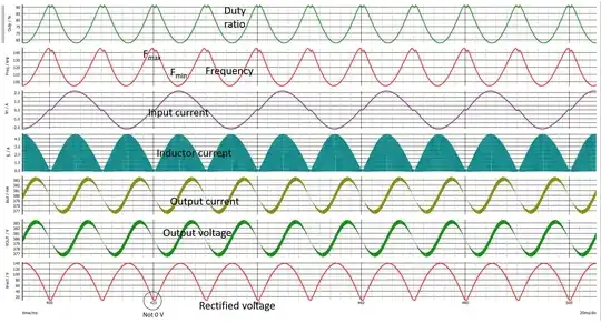

To visualize the inductor current in a PFC inductor, the best is to build a prototype or run a cycle-by-cycle simulation. The input voltage will be the grid sine wave and a dedicated circuitry will actuate a power switch on and off according to a control law. For a boost PFC working in a self-relaxing (no clock) boundary mode conduction (abbreviated BCM or CrM for critical conduction mode), the controller maintains a constant on-time along the input period to deliver nominal power and it naturally performs power factor correction. The frequency is changing depending where you are on the sine wave because magnetization and demagnetization times vary with \$V_{in}\$.

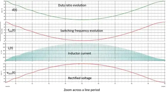

To look at the PFC inductor current, you can resort to an equation-based graph, build a prototype or simply run a cycle-by-cycle simulation. The one below is excerpted from my 60+ SIMPLIS templates that you can freely download from my webpage:
The simulation time takes 6-7 mn on my machine for a 800-ms run. If you zoom on a 100-ms period of time, you obtain the below graph. The input current is nicely sinusoidal, with some crossover distortion at the 0-V input region. Techniques exist to improve this by artificially increasing the on-time in this area:
You can see how the duty ratio and the frequency evolve along a grid period. I purposely increased the inductor to a few mH to reduce the switching frequency so that you can have a better look at the inductor current:
The averaged input current is the filtered version of the averaged inductor current. In a BCM-operated converter, the average inductor current is the peak current divided by two. Therefore, if the inductor peak current envelope follows a sinusoidal shape, the input current will also be sinusoidal. In voltage-mode control BCM, the controller blindly imposes a fixed on-time (adjusted with \$P_{out}\$) without sensing the input voltage (this is the simulated schematic I shown) while in current-mode control, the inductor peak current is set via a scaled-down image of the rectified voltage and the error voltage via a multiplier (see the venerable MC33262 from MOT).

    Okay this makes more sense to me now. It seems like over the course of one cycle (half of a rectified 60Hz/50Hz sine wave) the PFC controller does a lot to accomplish both objectives I laid out in other responses. Thank you! – RGB Engineer Aug 21 '22 at 18:29

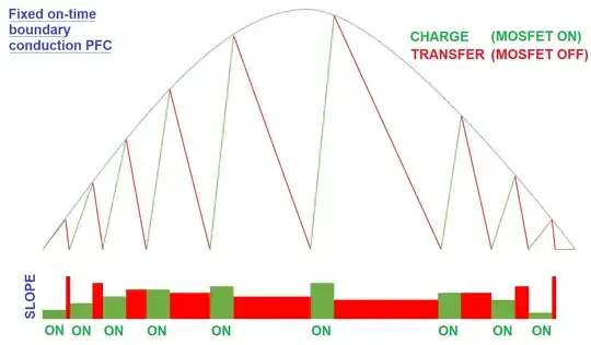

They are not very accurate at portraying the main subtleties. For instance, the falling slope of the current will always be a more constant rate because, the output voltage of the inductor is supplying (or topping up) the DC supply and, that DC supply (once established) is around 400 volts and constant. Maybe try this (that I drew for another answer): -
And, the main thing to observe is that the green charge lines are varying in slope as the AC voltage rises and falls over each half-cycle of AC. Also observe that the red transfer current slope is more constant (dumbed-down version).
  • So, green slope is proportional to the input AC voltage and red slope is less variable in slope.
Of course, as Tim Williams points out in a comment below this answer, it's a bit more complex than this because the red-trace slope will reduce as the input voltage rises towards its peak. The inductor only has to supply the difference between the output DC voltage and the input rectified waveform and, when the input voltage is closer to peaking, the voltage difference between input and DC output is less and thus the slope of the red line is less.
The waveforms above are dumbing-down the truth to make it easier to follow for the uninitiated. Dumbing-down is something that might help in this circumstance for the OP. But, it comes with a price and hopefully, that will be appreciated rather than scorned by people who are "in the know". Maybe this added picture will help (less-dumbed-down): -

  • @RGBEngineer you can infer the switching duty cycle from the picture; when the inductor is charging (green) the MOSFET is on; when the inductor is releasing it's stored energy to the output capacitor (red transfer current), the MOSFET is off. The line current (from the AC) is not regulated i.e. it is not constant; the current taken is made proportional to the rectified AC voltage and hence, although it is switching at high frequency, the average shape of the current is a half-sine-wave. – Andy aka Aug 20 '22 at 22:58

  • FYI: the figure with constant falling slope is correct for a SEPIC type converter, but it varies for boost because VL = Vout - Vin. – Tim Williams Aug 20 '22 at 23:41
    @TimWilliams you are absolutely correct and despite me dumbing down the answer to reach the level needed I became unstuck. I shall add a few words to clear this up. – Andy aka Aug 21 '22 at 00:03
  • In any case, it's a welcome sight over the cartoonish diagrams commonly seen in appnotes! – Tim Williams Aug 21 '22 at 02:14

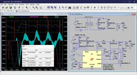

Here is a simulation of a PFC circuit using an LT1249 IC. It shows a comparison between a conventional FWB rectifier circuit and the equivalent using PFC. Note: I just saw that they both used 600 Hz AC input. I'll try again with 50 Hz to see if there is any significant difference.
PFC Circuit LT1249
I had to tweak some circuit components to get a reasonable response, but it looks OK at 50 Hz. Input current surges are definitely lower.
PFC Circuit LT1249 50 Hz
