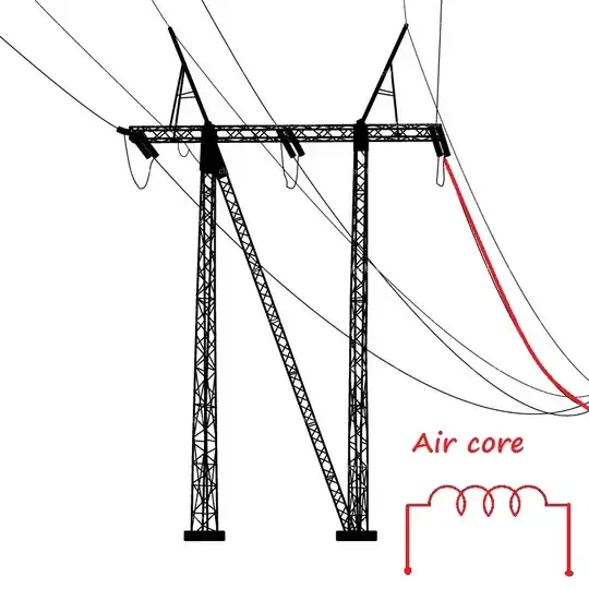

Back in the 90's I heard this story of a guy who in the 70-80's lived remotely near the power lines and that he was very good in electrical engineering and that he had free electricity by using the power line as a primary of an air cored transformer.
Besides the utter danger of going anywhere near the power lines I find it unlikely that having the second coil at a safe distance (which might be at least 10 meter) still can make this arrangement act like an air-cored transformer.
Is this theoretically possible or is it just a myth?

Yes, this is possible. I think the confusion comes from the fact that you are used to thinking about transformers being coils of wire around a magnetic core. However, that's just a good way to make a deliberate tranformer. The physical principle behind this is that every moving charge causes a circular magnetic field around it. Coils of wire concentrate the relatively weak field from the individual lengths of wire into a small area.
In your picture, the long and relatively straight transmission line wire will have a magnetic field around it proportional to the current thru the wire. If you were to run another wire close by the first wire, most of the magnetic field caused by the first wire would also go around the second wire. Since this current <--> magnetic field coupling works both ways, you would get a induced EMF in the second wire. Basically, you'd have a long stretched out air-core transformer. Deliberate transformers aren't made that way because they would be physically big.
Now imagine this transformer as the distance between the wires is increased. Less and less of the magnetic field caused by the first will go around the second wire. In transformer terms, the coupling decreases. However, it does not go to zero.
Let's say a farmer ran a wire fence to one side and underneath the power line. The coupling between the transmission line and a wire in the fence would be very poor, but with a long enough fence, could still pick up significant power. Considering the 100s of Amps flowing thru the transmission line, even very weak coupling stretched out over a long distance can be a meaningful amount. Over a mile or more, I wouldn't be surprised if you can pick up 10s of Watts with a carefully placed fence. I'd use something like a barb wire fence because you get individual conductors you can make sure are continuous, and it wouldn't look out of place if your property happened to border the power line right of way.

I have often considered moving into a van under some high-power power lines and doing this; so far as I can tell the physics works out, but there is an issue. Many transformers have a ferrous core, but that is just to guide the B-field, usually in a circle around through the other coils. Electromagnetic fields of course don't require a medium through which to travel, though, so the iron core in this case would not be necessary. The issue I mentioned earlier is that PG&E, or whoever puts up power lines, often runs them with the current going in opposite directions to cancel out the induced B-fields from the power lines, and without a changing B-field no current will be induced in the secondary coil. Or anywhere else, for that matter. If you live near a single power line or unpaired power lines, though, you could probably pull it off, though you would likely be caught. Side note, I don't think a barbed wire fence (suggested earlier) would work because the B-field from the power lines would be pointing straight down at the ground; that is, at the ground, the B-field is pointing down-- in other places it would not be pointing down. Anyway, point being, you would need a coil on its side so that the magnetic field could go through the middle of it.
