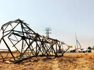

Due to country wide cable and transmission tower spar actual theft. We are looking at placing modules with a gyroscope and Wifi module to form a mesh that will report if a tower is being “attacked”. Of course I will still have to test if the electronic gyroscope is sensitive enough for this. But one of the problems is going to be, how to power the unit? Solar will require an extra solar panel and battery. If I could tap into the radiated energy from the actual transmission line, great. Many modern SOCs don’t require much power and can sleep most of the time.
To clarify our needs. We are looking at building a device to sense if parts of the metal tower are being removed by scrap metal thieves. If too many parts are removed from the tower. It will buckle and earth the line. This is still at the feasibility stage.

    No. We are building a device to sense if parts of the metal tower are being removed by scrap metal thieves. If too many parts are removed from the tower. It will buckle and earth the line. This is still at the planning stage. – kingchris Aug 11 '14 at 10:50

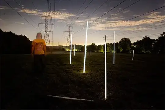

Entirely feasible.
Farmers were occasionally charged with power theft in this country (New Zealand) in the past. I haven't heard of a case in a decade or few - maybe they are getting cleverer at it :-).
This is the same principle as used for "IPT" / "Inductive Power Transfer as seen in phone chargers, industrial monorail powering, electric vehicle charging and much more.
I started to say that if the pickup coil was symmetrical with respect to two phases that were perfectly balanced that you'd get zero pickup, and then suddenly realised that I've always done IPT with essentially a single phase, and that with a 3 phase system with 120 degrees phase separation you should get the advantage of the full load current even if the two phases were fully balanced.
You are essentially getting fields produced by the current, not the voltage, and the voltage is essentially irrelevant as long as you observe the normal conventions that apply to any other dealing with xxx kV.

Yes, it's feasible (although entirely illegal - unless you work for the power company...). It's just an air-cored transformer. Get a coil into the magnetic field radiated by the transmission line and off you go.
That said, I'd do some sums and experimentation before hooking any electronics up to the output; you don't want to feed 10kV into your 3V embedded system...
