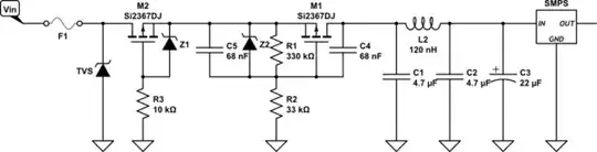

In order to reduce back-EMI of a Buck converter a LC input filter is to placed in front of the converter. To limit the inrush current when those caps are charged I consider to use a PMOS with a RC filter at its gate.
The following schematic shows the whole input stage including inrush current limiter (M1), reverse voltage protection (M2) and fuse.
During simulation I noticed that placing a capacitor from gate to source (C5) is much more effective in limiting inrush current than placing it from gate to drain (C4). This contradicts sources on the net like here that show the capacitor from gate to drain. Is the effect I see only in my simulation or is this due to the fact that I don't actively drive my PMOS but effectively tie it's gate to ground?
schematic

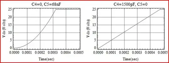

It is usually beneficial to use feedback around an active device, like C4 would provide to M1, when you can. That lets the gain of the amplifier work for you. Let's see how it works out by comparing the two situations separately.
As a thought experiment about the effectiveness of C4 and C5 for inrush current limit, consider the two plots (generated using a 1st order model of the FETs). Vin is set as 25V. Load capacitance is 31uF. FET modeled was SiA441. Gate resistance (R2) was 30 kOhm, and gate voltage for turn on was set to get about 100uA of gate charging current in the Miller switching scenario. The same gate drive setup was kept for the passive RC case. In each case time required for the gate to rise to \$V_{\text{th}}\$ were removed to get rid of switching delay.
The first plot shows C5 of 68nF without C4, so just a passive RC on the gate to slow down turn on. Peak rate of rise of drain voltage is about 5V/35uSec, for a peak charging current into 31uF of 4.5A. Most of the charging takes place in about 200uSec.
Second plot shows C4 of 1500pF without C5, using the Miller effect to slow down turn on. Value of C4 was reduced from 68nF to 1500pF to have turn on be between 400 and 500 uSec. Rate of rise of drain voltage is about 5V/100uSec, or about 1.6A charging current into 31uF.
If the only concern were turn on time and inrush current, the configuration using C4 and the Miller effect would be the way to go. But, there are other things going on, so let's look at those.

I assume you mean "C5" as the gate-to-drain capacitor, not "C6".
I'm not sure what you mean by "more effective". Yes, it takes a lot longer to charge C4 than it does to charge C5, because you're depending initially on the leakage current through M1 to get things started. But this current will vary a lot from part to part (and with temperature), so you can't really depend on it being any particular value.
It would be better to use C5 and set the R-C time constant to what you need. This will be a lot more repeatable.
