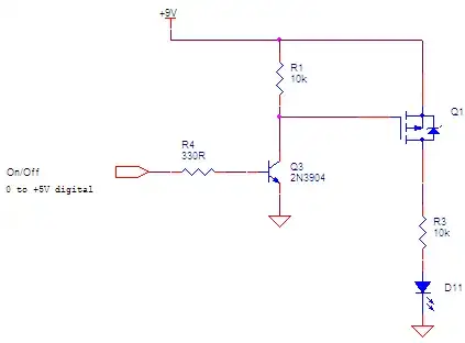

There is an error in the O.P. circuit. It will not be able to turn off the LED, so the LED will be on all the time. To turn off the P-channel MOSFET, you need to pull the Gate to Source. The Source is always at +9V in your circuit, but the pullup R1 goes only to +5V (VCC).
A high side P-channel MOSFET switch often looks like this.
Q2 can be a small N-channel MOSFET or a small NPN transistor.
On the other hand, is there a reason for using a high side P-channel switch (as opposed to a low side N-channel switch)? Are you making this setup just to understand P-channel MOSFETs better?

  • @kolosy The size of the pull-up R1 determines how quickly Q1 will turn off. Gate capacitance of Q1 is discharging through R1. Both pull-up and pull-down can be 10k (especially if you are not shooting for very low power operation). – Nick Alexeev Apr 15 '14 at 18:23

    i just breadboarded the bottom version, using a 2N3904 NPN, a IRF9540 PNP mosfet, driving a 50W LED. Controlled by a schmitt NAND oscillator. Works great! – johny why Nov 14 '17 at 02:39
  • @NickAlexeev "Are you making this setup just to understand P-channel MOSFETs better?" In my case, reason is that uC is booting with HIGH state on a certain available pin, which turns ON the external device for some short period. Solution for me was to use NPN to drive PNP that is providing higher side (above uC's) Vcc to the device. – Vladimir Djuricic Dec 25 '20 at 07:23

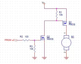

There are a few things to change in your circuit:
  1. You want to pull the MOSFET gate to 9V, not VCC.
  2. Once you do this, you can't use the LED_EN pin directly, because it likely won't be 9V-tolerant.
  3. To fix this, you can use an N-channel MOSFET to pull down the gate of the P-FET.
  4. You'll need a current-limiting resistor on the LED.
Here's a diagram I did for another answer:
PMOS
This is driving a motor, but the same circuit works for driving an LED (with an additional resistor). I think the linked answer will give you some good info, too, if I do say so myself! :)
Good luck.
