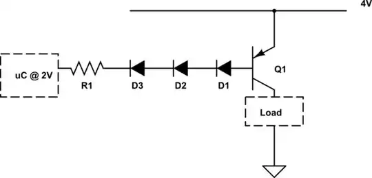

PNP BJT switch with three diodes
AVR docs state that the chip cannot "see" more then 0.5V above Vcc on any of the pins, so one option would be to use a diode \$V_{forward}\$ to present a lower voltage to the uC:
schematic
Perhaps D1 can be omitted? I am not sure if there is a E->B voltage drop in a PNP transistor.

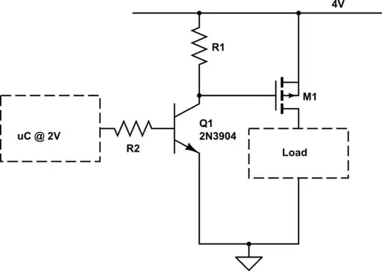

P-Channel MOSFET with an NPN BJT
Another option is to control the P-Channel MOSFET with an NPN BJT
schematic

    P-Channel MOSFET with an NPN BJT is the simplest choice. No real component-matching is required; you can build it with whatever you have lying around. If Q1 were a MOSFET (with low Vgs threshold) you could do away with R2. – CharlieHanson Jan 01 '16 at 18:17
    I agree with @CharlieHanson. Just want to add that the diodes will not really protect the uC input against high voltage, because the diode voltage will be zero unless some small current flows. Also wanted to add that a PNP BJT does have one diode drop between emitter and base. – user57037 Jan 01 '16 at 18:46
  • Ah, good point about R2 @CharlieHanson - hice. – angelatlarge Jan 01 '16 at 18:49

  • Why not using NPN to drive PNP? Pull-up resistor at PNP's base with higher values could be used to lower the current as much as possible. And NPN base resistor could also be with high value, too. – Vladimir Djuricic Dec 19 '20 at 10:18

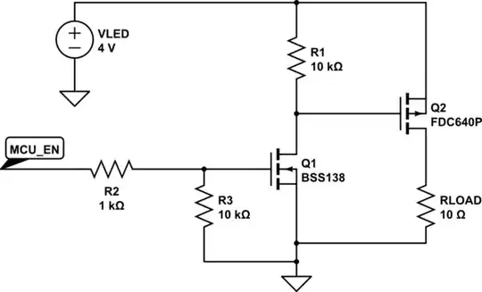

Yeah, I think Option 2 is your simplest high-side option. Replace Q1 with a BSS138, and you can have a simple all MOSFET solution with discrete parts.
Alternately, if you're OK buying ICs, you can use an IC like the TPS2557 (which is an N-channel load switch with built-in charge pump), or an integrated dual N/P part like the Si3865DDV which basically squeezes the option 2 circuit into a convenient package. These would also take up less space than the discrete solution, and offer some protection features such as current-limiting if you would like. I can also understand the appeal of building something with parts you have lying around.
A N-channel device will have a lower on-resistance than a comparable P-channel device, but it does require a charge pump as you stated.
Finally, even with a MOSFET solution, I would personally keep R2 there and make it 1k or so, in addition to adding a pull-down to your UC enable pin so that when you are in reset, the LEDs stay off. By keeping R2, if you drop a screwdriver or something across the gate of the MOSFET to GND, it limits the current that can flow from the uC pin.
Here's the discrete solution:
schematic
Krunal Desai

I vote for the second solution because the first one's kind of iffy with respect to the the 2AA battery voltage, Q1's Vbe, and the diode drops needed, while the second solution is rock-solid, especially with respect to the impossibility of ever back-driving the MCU I/O to any positive voltage.
