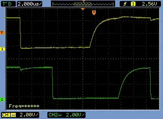

In a digital wall clock I designed (using the DS1307 RTC and the ATmega328 MCU), I accidentally omitted the pull-up resistors that must be wired to both I2C lines. In the end I was lucky enough that the internal pull-ups on the ATmega I2C lines were enough to (barely) allow the communication between the devices. The result were long rise times on the I2C lines and speed reduction to 32kHz as seen in the scope shots below.
Edit: Actually, the frequency is exactly 100kHz - there are 2 peaks per 20us on the green trace. I initially thought there was a reduction to 32kHz because my scope calculated the frequency on the yellow trace.
Scope shot 1 Scope shot 2
What's puzzling me now is how the devices decided that 32kHz was enough for the communication to take place. The DS1307 datasheet says that the device supports 100kHz frequency on the I2C bus. How come it ended up using 32kHz instead? Is there some kind of handshake phase where the frequency is stablished?

  • Actually, the frequency has always been exactly 100kHz - there are 2 peaks per 20us on the green trace. I initially thought there was a reduction to 32kHz because my scope calculated the frequency on the yellow trace. This makes your answer correct. Thanks!! – Ricardo Oct 12 '14 at 01:05
