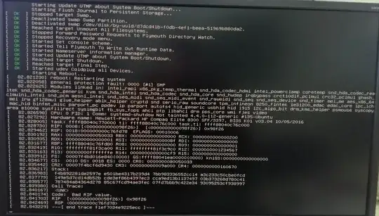

I have already discarded the problematic kernel (purged) and switched to 4.4.0-109 and as of today to 4.4.0-112, but one problem still remains: the failure to reboot the system. Everything else seems to work fine, except from the rebooting operation.
Here, you can see a printscreen picture from the problem:
printscreen
Any suggestions on how to handle this issue?

For my home non-production 16.04 LTS machines I made the following decision:
I'll stay on 4.4.0-104 (and 4.4.0-103 as fallback) and 20170707 intel-microcode for complete and safe Meltdown and Spectre fixes which do not have side-effects (I do not mean speed here).
So I removed new kernels, reinstalled 103 and 104 and pinned corresponding packages.
Warning: do not follow steps below if you are using Ubuntu on production server or enterprise desktop.
Here are my steps to achieve this:
