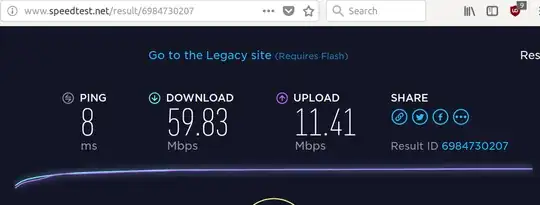

    However speedtest.net reports almost 60 Mbps throughput:
    internet speed wifi
    Running the same test on an Ethernet adapter rated at 1000 Mbps results in same 60 Mbps Internet download speed. So speed is limited by ISP not by WiFi. Relevant lspci -vv:
