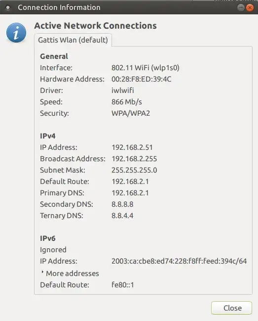

Here is screenshot from NetworManager Networ Manager screenshot
Here is conky screenschot
It seems that conky checks download bitrate only an connection and does not update this value.
How can i enable update of this value? Also question: wich option shows ethernet connection Rate(speed)?
UPD
From comment @WinEunuuchs2Unix
Command iwlist shows all time one fixed speed.
Here is example with watch
Every 1,0s: iwlist wlp1s0 bitrate                       Sun Apr  8 18:58:12 2018
wlp1s0    unknown bit-rate information.
      Current Bit Rate=144,4 Mb/s

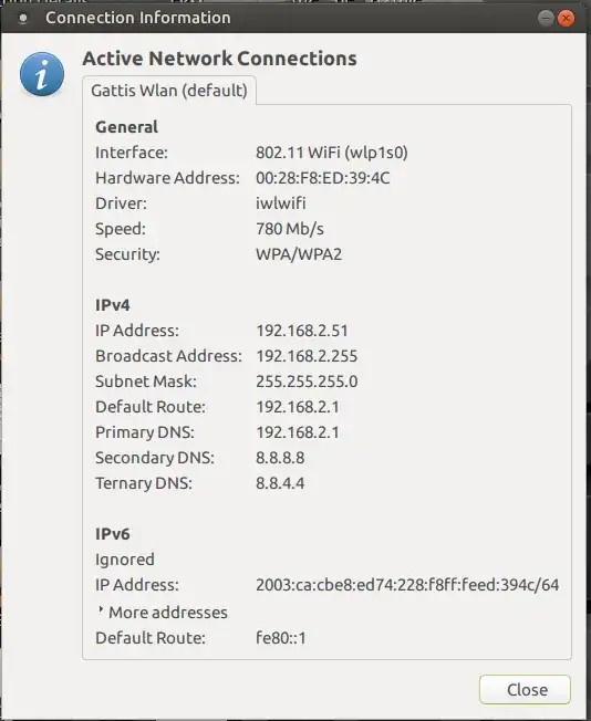

But NetworkManager show that speed is changing.
Screenshot in front of router: enter image description here
Screenshot in other room: enter image description here
