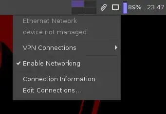

I installed Ubuntu 16.04 today through minimal-install. At first my networking was ok (after installing network-manager), but now I have no internet. I only did some theming and installed a few applications, didn't fiddle with my networking. When I open my nm-applet I see this: enter image description here

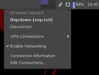

After a short search I managed to get my ethernet to work, through editing /etc/NetworkManager/NetworkManager.conf (managed=true)
However, my wireless networks are still unavailable, and the ethernet doesn't have its proper name.
Does anyone know what might have gone wrong and how can I fix this?

To get Network Manager to take over all interfaces correctly, remove the ethernet settings in /etc/network/interfaces like this:
# This file describes the network interfaces available on your system
# and how to activate them. For more information, see interfaces(5).
source /etc/network/interfaces.d/*
# The loopback network interface
auto lo
iface lo inet loopback
Next, return NetworkManager.conf to its default state where managed=false.
Finally, restart Network Manager:
sudo service network-manager restart
It may take a reboot.
