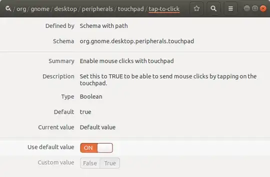

I resolved this by turning off tap-to-click in dconf-editor (/org/gnome/desktop/peripherals/touchpad/tap-to-click).
screenshot
However, although this was already set to false, it was still responding to taps on the touchpad. To resolve this, I followed the instructions from here.
