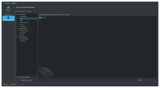

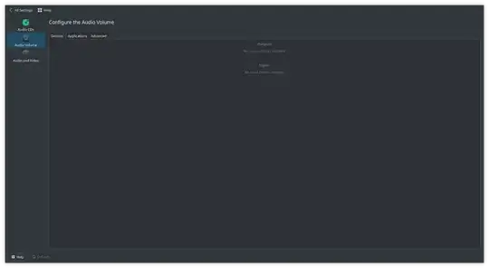

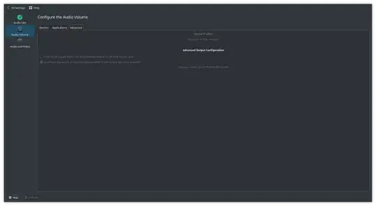

I just freshly installed Kubuntu 17.10 from a bittorrent image from the Kubuntu.org website, and this has regular audio, but upon a few restarts, audio devices disappear from the list, and there is no sound. There are no audio devices listed: No Devices No Devices Continued Only Default

Edit 2: This problem is rather persistent, and will still occur after another fresh reinstall. It appears to happen at random, with no identifiable cause. Most times it will be fine, and then one restart of the system later, it will be buggy with no audio devices listed, and this state will then persist for all future restarts of the system.

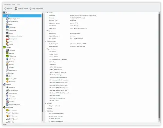

Edit 3: Hardware Info Hardware Info

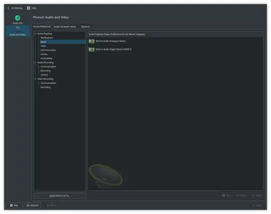

Edit 4: Attempted Fix: Purge pulseaudio Then Reinstall It
Had limited success. Sound restored, and some devices are back. I'm not sure if it works with bluetooth (I'll check later). There is some buggy behavior left still. For instance, check the before and after pictures of System Settings/Multimedia one of the tabs is missing, also, the sound slider will not function. I subverted this by installing kmix, a substitute. I don't know the default package for the hardware volume slider or how to get the system back to a less buggy state.
After Attempted Fix
