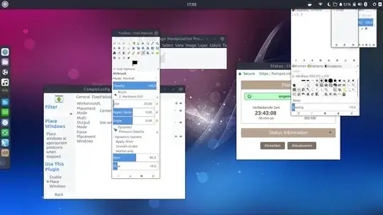

I've encountered a simple problem - some windows appear behind the panel. I did my little Research and still ain't able to have an solution.
GNU Image Manipulation window behind panel:
GNU Image Manipulation Window behind Panel
Can anyone relate, get me out of this anger? It interrupted my workflow for like 20 minutes.

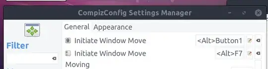

Using Alt+F7 after clicking the window seems to be a possible the solution.
And since a picture is worth more then 1000 words:
Credits: yikeu, i.e. the last line (= "edit ...") in the question, which should actually have been posted as an answer ...
