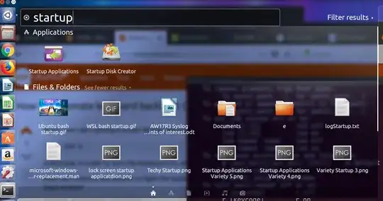

  • Select the first option on your Launcher called Dash. Then type "startup" and a screen similar to this will appear: Dash Startup applications.png

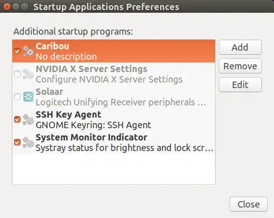

  • Select the option "Startup Applications" and a screen similar to this will appear: Startup Applications 2.png

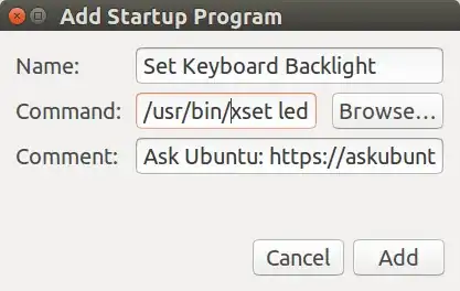

  • Select Add and this screen will appear: Startup Applications 3.png
  • Make sure you enter the command as: /usr/bin/xset led 3
  • I entered the comment as: Ubuntu 16.04 regular crash, Compiz segfault, error 4 in i965_dri.so, Fresh install but you don't need to.
