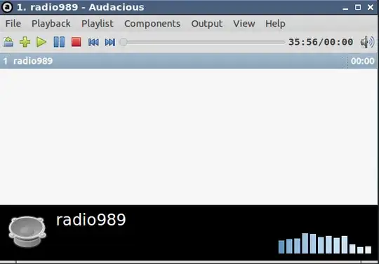

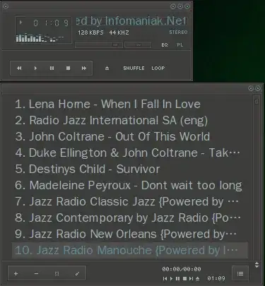

Audacious is integrated in Lubuntu by default, because of its light-weightedness. You can try it: sudo apt-get install audacious. It supports two different layouts: a GTK-interface, and a Winamp-like interface, from which the latter can be skinned. It doesn't support Unity Sound Menu integration.
This is the GTK-interface.
Above: the GTK-interface
This is the Winamp-like interface
Above: the Winamp-like interface

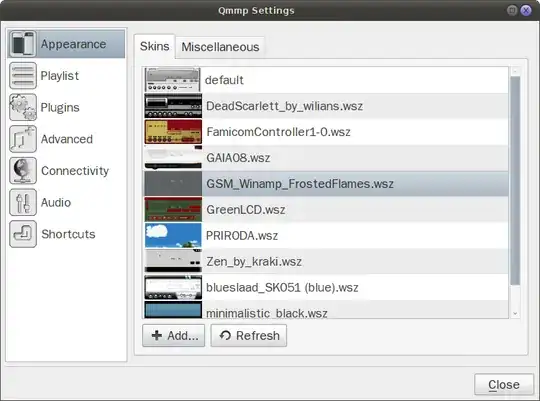

Try qmmp Install qmmp.
It's very similar to winamp and supports winamp skins. Right click on the interface, 'Settings' (Ctrl-P), 'Appearance' - Skins - Add.
or copy the .wsz files to ~/.qmmp/skins
Can handle multiple playlists - go to 'Settings' (Ctrl-P), 'Playlist' and check 'Show playlists'.
And it will look like so (example with a different skin):
It's in Ubuntu repositories.
