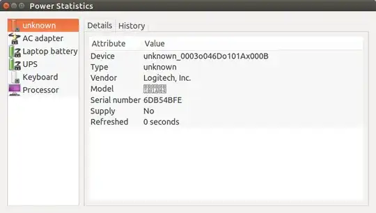

In a Ubuntu 16.04 fresh install the Battery status for the mouse is showing up as unknown:
Logitech mouse unknown

  unknown
    warning-level:       none
    icon-name:          'battery-missing-symbolic'
  History (charge):
    1514753967  0.000   unknown
  History (rate):

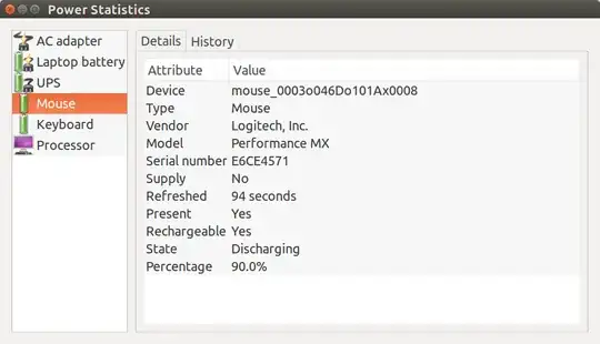

Then I rebooted twice. On the first reboot the external display didn't appear and the login prompt was delayed. On the second reboot everything was normal and the Power Statistics appeared as they should:
Power stats normal
