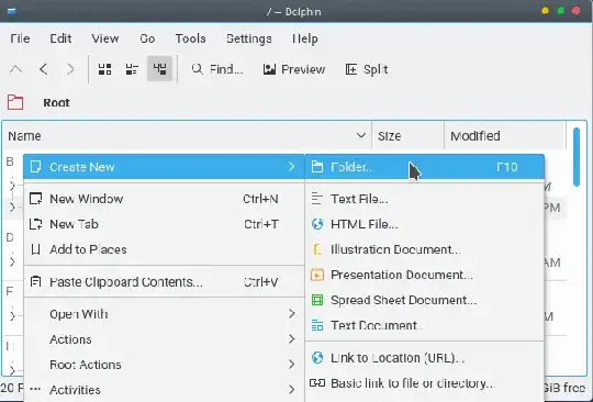

Not an answer, just a workaround for the purpose mentioned by the OP (copying or deleting files).
The idea is to
  1. install another file manger that doesn't have that limitation and that doesn't bring a lot of dependencies
  2. create an "Open as root" context menu in Dolphin for this other file manager.
The main file managers of other desktops can be used (Nautilus, Nemo, Caja, Thunar) but they do bring some dependencies. Even PCManFM and PCManFM-Qt do that. If you need one of those for some other purpose adding that one could be a good solution.

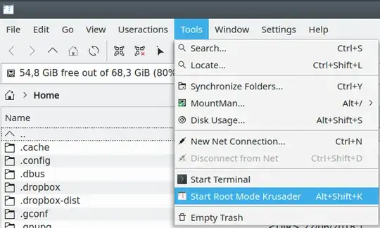

I have found that Krusader (which I think in the past used to be installed by default in some KDE systems) can be easily installed, brings no dependencies in Kubuntu 18.04, and can be used as root.
sudo apt install krusader
Under its Tools it has the "Root" option.
which asks for password in a gui.
To add a context menu in dolphin, create the folder ~/.local/share/kservices5/ServiceMenus and then do
kate ~/.local/share/kservices5/ServiceMenus/filemanager_root.desktop
and add
[Desktop Action root]
Exec=/usr/lib/kde4/libexec/kdesu krusader
Icon=dolphin
Name=Open in Krusader file manger as administrator
[Desktop Entry]
Actions=root
Icon=krusader_root
MimeType=inode/directory
ServiceTypes=KonqPopupMenu/Plugin
Type=Service
X-KDE-Priority=TopLevel
X-KDE-StartupNotify=false

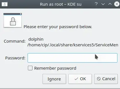

For some reason kdesu krusader doesn't work, and I have used the solution from here.. What also works is konsole -e sudo krusader, but that shows the terminal instead of a gui for the password prompt.
Then, you'll see in Dolphin:
bringing a dialog
which is one that works..

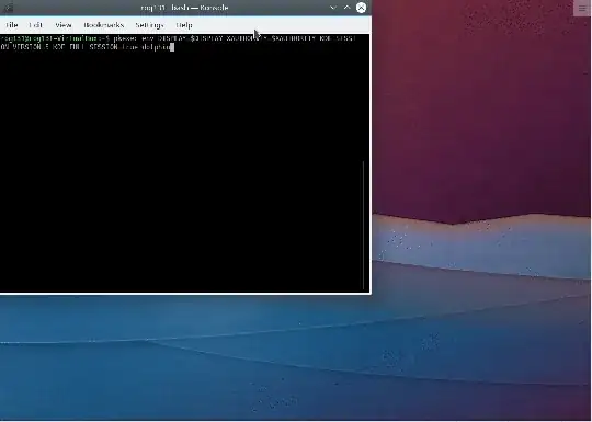

here it is a workaround for Dolphin 17.x:
export XDG_CURRENT_DESKTOP=KDE; LD_PRELOAD=/home/roger/Downloads/dolphin/usr/lib64/libkdeinit5_dolphin.so /usr/bin/dolphin
get libkdeinit5_dolphin.so from here
Tested by me, it works fine in Ubuntu bionic.
