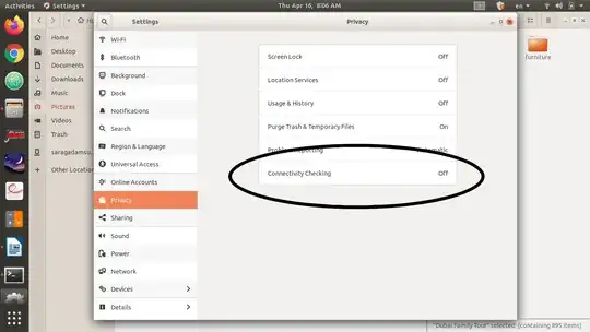

This status of Question Mark “?” Sign or a “?” indicator in the Network Manager Applet despite the network status connected “is not an error in Network Manager” you need to change the settings of connectivity checking to OFF
How to get rid of that “?” Status in the nm-applet is goto
Goto to -------- Settings/Privacy/Connectivity Checking – and Switch it off.
