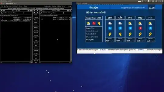

As can be seen in the screenshot, I have a problem with a mouse trail showing up on screen:
screenshot
I'm running Ubuntu 16.04, with Intel graphics driver, and pass trough Yamaha receiver.

The answer was found in the case: “Solution” to Intel Graphics Screen Tearing/Flickering Causes Excessive Fan Use in Ubuntu 16.10/17.04/17.10
The correct solution would be to create the following folder and file:
sudo mkdir /etc/X11/xorg.conf.d
gedit /etc/X11/xorg.conf.d/20-intel-graphics.conf
you can use any text editor you prefer
copy then paste the following content:
Section "Device"
   Identifier  "Intel Graphics"
   Driver      "intel"
   Option      "TripleBuffer" "true"
   Option      "TearFree"     "true"
   Option      "DRI"          "true"
EndSection
remember to save the file
Do not create these files in /usr/share/X11/xorg.conf.d. That is the location for example configuration files for X, not the ones that are actually loaded.
