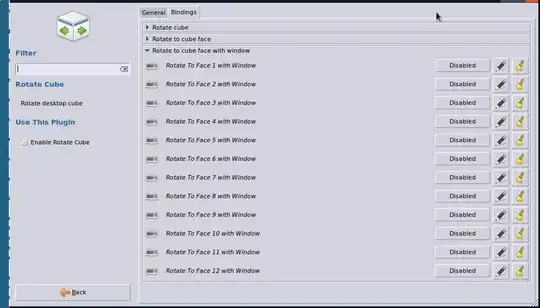

I am using Desktop Wall instead of the Cube, which is awesome but I got tired of the cube, then I switched to Desktop Wall. Which features key bindings for "Move within wall", "Move with window within wall" and a few other. I have the default setup which includes Shift+Control+Alt+[Key] (left, right, etc.) in order to "move" the window to the desired wall. As shown here:
The Cube features the same binding options in the appropriate tab inside of the "Rotate desktop cube", which may be useful for you as you can define several combinations for your desired key bindings in order to move your windows to a specific Face (n) (of the cube).
If you are using more than a single horizontal workspace, then you probably have a 4 faces cube with dual workspaces, which means: only one cube, with selective workspace. This way, you can combine both the Desktop wall key bindings with the Rotate Cube key bindings in order to obtain the effect that you expect to.
But you should first check if the normal Shift+Control+Alt+[Key] (left, right, etc.) are doing the trick. Otherwise this workaround may be tricky for you. (not tested by me, I am not using the cube anymore).
