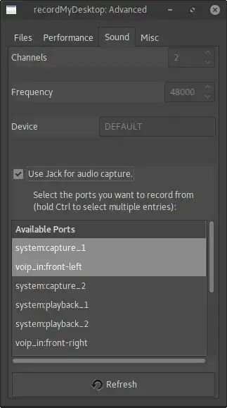

Bigger question that needs to be worked out first is - how can i create a working JACK sound system with all required audio recording sources? Answer to that is beyond scope of a short question on here
Assuming working JACK audio, audio recording settings in recordmydesktop:
recordmydesktop sound settings
will create the recording connections in JACK:
qjackctl connections
This is not a stereo mix. recording two sound sources in mono makes it easier to edit in post-production.
Recording all sources in stereo is possible by adding more connections in qjackctl, or using a mixer in JACK
