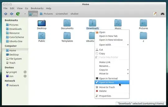

Nemo already has the functionality to open a folder in a new Window with root permissions. You just have to right-click on a folder icon and select "open as root" in its context menu.
Screenshot of Nemo with folder context menu Image source: http://2.bp.blogspot.com/-4PwLsyex1Bo/UEqi2kD9h7I/AAAAAAAAANU/iHXfQRKdMfw/s1600/nemo-file-manager-open-as-root.png
When you click on that option, you will get the gksu-popup asking for your admin account's password. After correctly entering this, a fresh second window of Nemo opens at the selected location.
