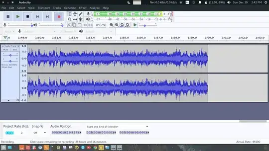

  1. Use Audacity
  2. Remove any headphones/mic plugged in
  3. Use recording source as default ( if not working, try trial and error )
  4. Click the " Record " button ( a maroon dot )
  5. You can see the GUI listing variations if audio is recording
  6. Start and stop at desired points
  7. Save as Audacity project
  8. Delete unwanted part of the audio
  9. Use File > Save other > Export as mp3 to your desired location
