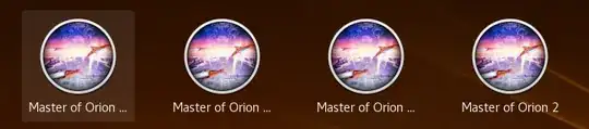

Basically when I search for an application, if the name is too long it's shortened with an ellipsis (...). I want to know how to change it so that the whole name is displayed. Example: When searching for "Master of Orion
I hope it's OK to ask for an updated answer.
I'm using Ubuntu 17.10 with GNOME Shell 64-bit.

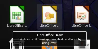

As a workaround you may use a GNOME shell extension called Applications Overview Tooltip. It
Shows a tooltip over applications icons on applications overview with complete application name and description.
(screenshot source: extension's homepage at extensions.gnome.org)
