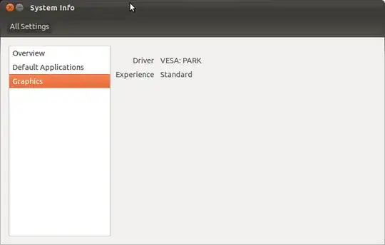

which is the same as in the post above but i have choppy video even playing 720p. Graghics in System info display this
Driver VESA:PARK
Experience Standard

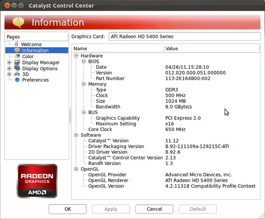

The output of sudo glxinfo | grep -i direct is:
direct rendering: Yes
GL_AMD_multi_draw_indirect, GL_AMD_name_gen_delete,
GL_ARB_draw_indirect, GL_ARB_draw_instanced,
GL_EXT_copy_buffer, GL_EXT_copy_texture,
GL_EXT_direct_state_access,
The output of sudo lspci | grep VGA is:
01:00.0 VGA compatible controller: ATI Technologies Inc Manhattan [Mobility Radeon HD 5430 Series]
wget http://www2.ati.com/drivers/linux/amd-driver-installer-12-1-x86.x86_64.run
sh amd-driver-installer-12-1-x86.x86_64.run
Then choose to build package for your detected distribution. Then you can install the .deb package with
sudo dpkg -i fglrx_8.930-0ubuntu1_amd64.deb fglrx-amdcccle_8.930-0ubuntu1_amd64.deb fglrx-dev_8.930-0ubuntu1_amd64.deb
