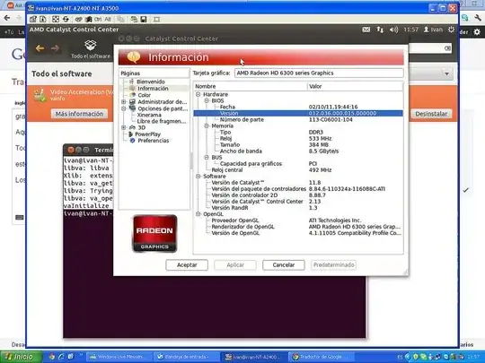

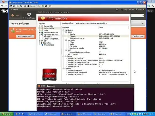

I have not yet installed / uninstalled anything in the system. This PC came with the system preinstalled. ATI drivers are installed.
Here I have picture with info on X:
Sorry:
This image shows vainfo information and drivers of my system.
