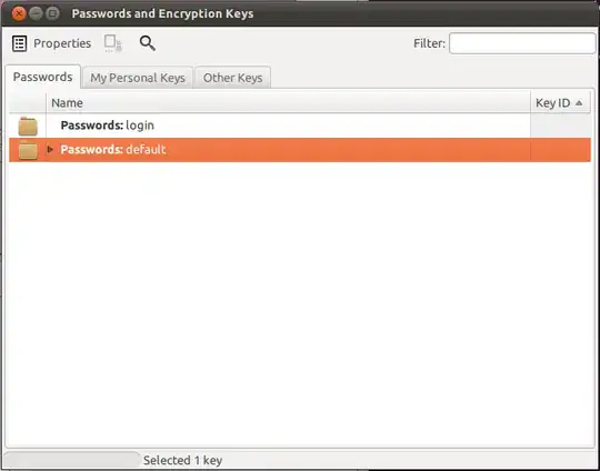

The "Passwords & Encryption" application is the unusually named seahorse
You can check that it is installed by typing seahorse at the command-line to launch it.
You can install the application via:
sudo apt-get install seahorse
This is actually a GUI app front-end to GPG that looks like this:
Thus if you want to stick to the command line you could just install gnupg and gnome-keyring - but you will need to manipulate gnupg via its command-line interface (man gnupg).
Obviously, the GUI front-end is easier!
