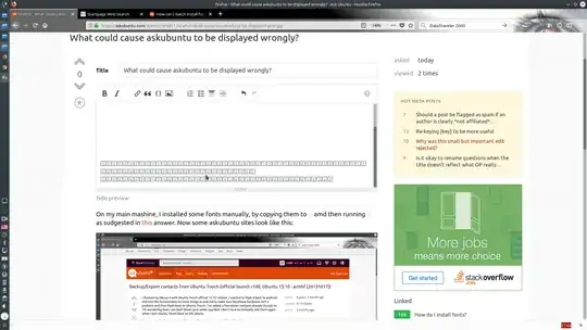

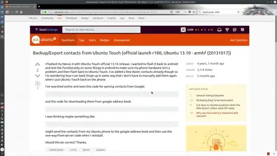

On my main machine, I installed some fonts manually, by copying them to /usr/local/share/fonts/ amd then running sudo fc-cache -fv as sudgested in this answer. Now some askubuntu sites look like this:
and I cannot see the posts I write. Are the two events related? Or, how can I arrive at the bottom of this? Using another Firefox profile on the same machine, does give me the same problem.Using chrome however does not.
