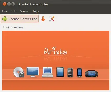

Arista can do both of these things, and it provides a very nice, easy GUI. It's available in the repos.
Screen of Arista

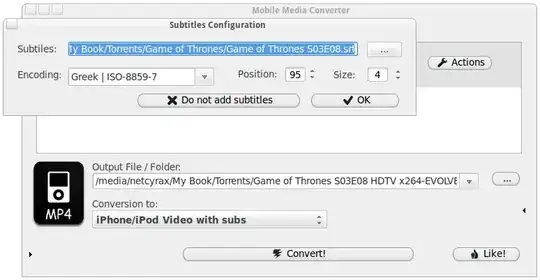

You can use Mobile Media Converter to do these task.
Mobile Media Converter subtitles window
You can download from here.

In the Arista:
  1. Select "Create Conversion" to get the "Create Conversion" window
  2. Select "Choose File..." as the "Source"
  3. Select the video file
  4. Click on the "gear" next to the "Source" to get the "Source Properties" window
  5. Set "Subtitles to render"
