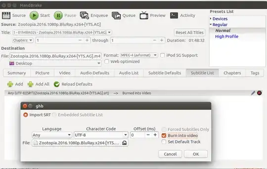

I use Hand Brake on my ubuntu 16.04 great application and very simple to use . https://launchpad.net/~stebbins/+archive/ubuntu/handbrake-releases
Installation:
sudo add-apt-repository ppa:stebbins/handbrake-releases
sudo apt-get update
sudo apt-get install handbrake
How it work:
  • Click on source and chose movie.
  • From subtitle List tab click on Add.
  • don't forget to tick on Burn into video. List item
  • finally click on Start.

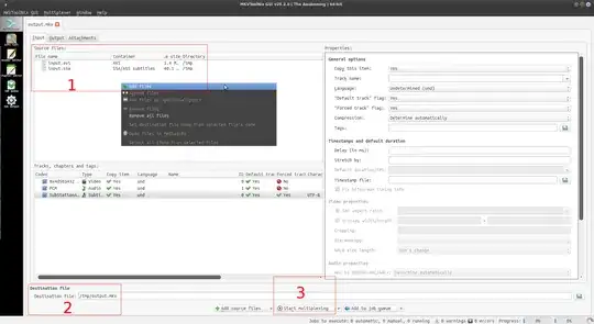

I think that MKVToolNix is the simplest and easiest-to-use free tool available for you to merge a video file with a subtitles file. Just install it by e.g. running a terminal/shell command such as:
sudo apt-get install mkvtoolnix mkvtoolnix-gui -y
...and then run it, right-click the Source files area in order to add your video file and your subtitles file (step 1, at the picture below), specify the location of the destination MKV video file (step 2) and then click on Start multiplexing (step 3). Done.
MVKToolNix's main window
MKVToolNix muxes/multiplexes the subtitles track/stream along with the video track/stream. This means that the output MKV file, like e.g. ~/Videos/output.mkv (the ~ character is a shortcut to your home account folder, e.g. /home/your-account/), will be a video file that contains subtitles embedded in it and you will be able to turn the subtitles on and off, while such MKV video is playing.
PS: if your Android TV doesn't play MKV video files, use MX Player, Kodi Player or VLC Media Player to add MKV playback support.

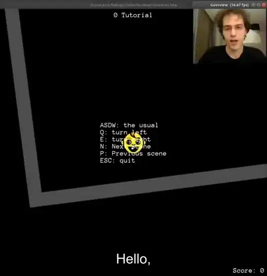

The generated output can be seen at: https://www.youtube.com/watch?v=Q0nVA3mYXLU

where:
With that said, .ass is a superior format as it can encode font appearance, so it is the best option if you are generating the subtitles yourself.
Tested on Ubuntu 20.04, ffmpeg 4.2.4.
