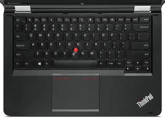

I have Lenovo Thinkpad Yoga 14 which has PrtSc key on the keyboard. I personally find this key totally useless as I prefer using Screenshot application to select the required area and take a snapshot. I am trying to change its functionality to the Menu key, which can be used to access context menus similarly to right clicking. But I am not able to find this setting. How to do it?

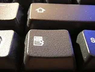

As a workaround you may access the right click functionality by (the "menu" key) or Shift+F10 combintion.
The menu key looks like this:
(Image source)
