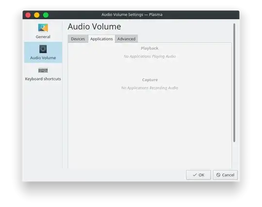

In Settings, I can't change anything related to audio since the system claims there's nothing there. Settings > Multimedia > Audio Volume. No ouput/input device found.
settings1 settings2
Strangely enough, Spotify and VLC is making sounds. But not Firefox, not Pillars of Eternity (Steam (Flatpak)). And nothing show up in settings. Those pics were taken while playing music in Spotify.
