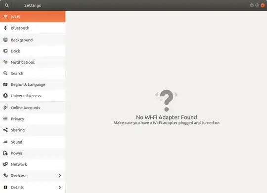

“No Wi-Fi adapter found” is the message I got after installing Ubuntu 17.10.

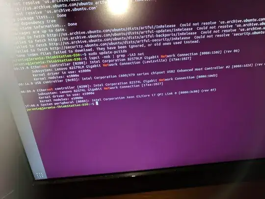

With the following command line lspci -nnk | grep -iA3 net, I got the following message. How could I fix that issue?
Here is the error shown in the settings:

The wifi hardware adapter is not shown in your output. I only see LAN adapters.
It is difficult to provide a solution with this information.
