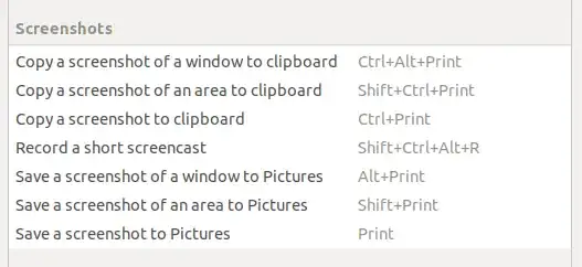

The PrtScr/Print key still works – but now (U17.10) has different actions bound to it. Go to
Settings → Devices → Keyboard
and scroll down to Screenshots. It shows
If that's sufficient for you and you can remember these keystrokes, then you are done. Else refer to @pomsky's answer and set up a shortcut to launch gnome-screenshot --interactive instead.
