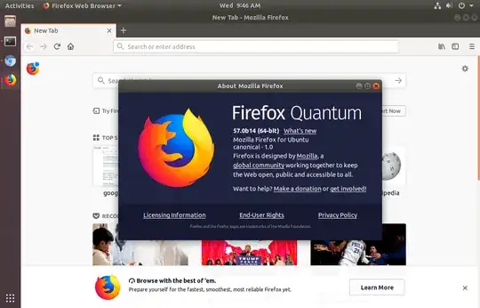

If you like the beta, Firefox quantum is in the firefox-next ppa
https://launchpad.net/~mozillateam/+archive/ubuntu/firefox-next
sudo add-apt-repository ppa:mozillateam/firefox-next
sudo apt update
sudo apt upgrade firefox
Installing from the ppa is better , IMO , than manually replacing system files. It is easily reversed and will not cause system conflicts.
