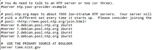

Time server settings are saved in /etc/ntp.conf so open your favorite editor and make this simple change.
sudo vi /etc/ntp.conf
The relevant section looks something like this (It may say ubuntu instead of debian, but it is the same problem either way):
So all you need to do is change it to look like this on all the relevant computers:
then reboot them.
Voila, the systems are now all using the NIST/NBS Master Clock to synchronize. Stratum 1 is the primary source, and Stratum-2 are a single hop away from it.
The pools are anywhere from 12-16, just like Windows when it uses pools.

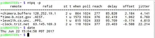

You can verify that it is working at Level 1 by using this command:
ntpq -p
Which gave me this output:
FileZilla is now running unbelievably faster as it is able to skip more files! Amazing difference. Time synchronization is an excellent experience.
This is the best that can be attained via the Internet.
time.nist.gov is a load balancer that will find the best server for any particular location.
