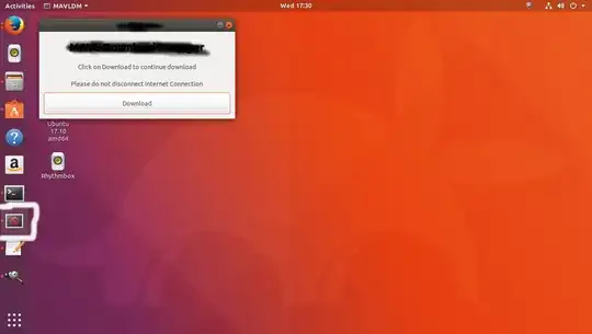

I created an executable .desktop file in my Desktop which should launch a GUI application along with displaying an icon in dock, but in Ubuntu 17.10 icon is not displaying in dock:
desktop with download dialog

First right click on the .desktop file and select Properties. Then go to Permissions tab and check the "Allow executing file as program" if it's unchecked. Alternatively you may run
 chmod +x <filename.desktop>
Then double-click on the .desktop file, a window with the heading "Untrusted application launcher" should pop up (as in your second screenshot). Click on the "Trust and Launch" button. The .desktop file should be fixed now (i.e. should show correct name and icon specified inside the file) and the application will be launched.
From next time on it won't ask for any permission and launch the application straight away.
