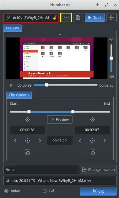

The plumber tool allows you to do this easily. Install the application with:
snap install plumber
After installation, it will appear in your applications menu.
When you run the application, paste your desired youtube link in the box (highlighted in red in the screenshot below), or use the built-in youtube search feature, by clicking the youtube icon (highlighted in yellow).
Choose the start and end points. You can save your result as a video or gif. plumber application window
