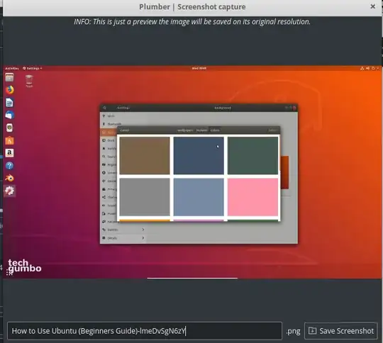

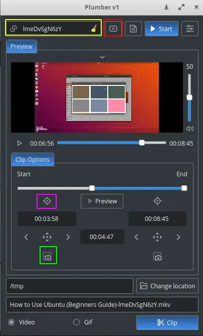

The plumber tool offers the ability to grab a screenshot of a single frame in a youtube video. To install the tool, type the following in a terminal window:
sudo snap install plumber
Paste the youtube url in the box marked in yellow, or use the built-in search function by clicking the icon marked in red.
You can then find the desired frame in the video and click the icon marked in pink, followed by the icon marked in green, which will open another window to show a preview of the screenshot and allow you to save it as an image file.
The tool can also be used to save videos/gifs of a clip of a youtube video.
plumber main screen
screenshot window
