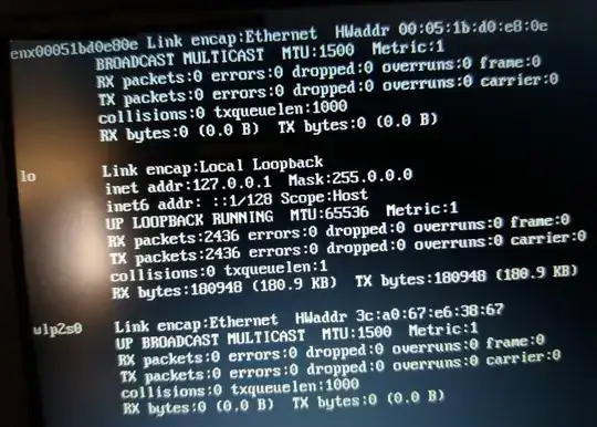

and here is ifconfig -a:

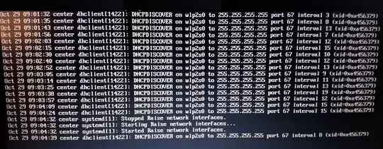

and here is /var/log/syslog after sudo service network restart:
The interface for your USB ethernet is enx00051bd0e80e and not eth0. This is a result of predictable network naming: https://www.freedesktop.org/wiki/Software/systemd/PredictableNetworkInterfaceNames/
Your settings for wlp2s0 in /etc/network/interfaces are faulty. As well, since you are not asking to connect by wireless, but ethernet, I suggest that you remove the wireless settings altogether. I suggest that you amend the file:
