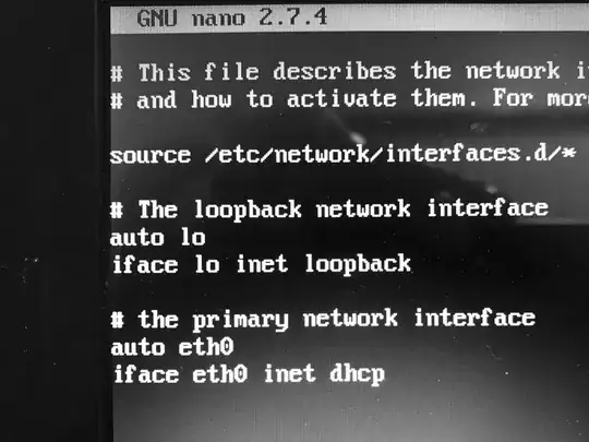

some shots from other results;
interfaces file
also the above photo i added the lines "#the primary network interface, auto eth0 iface eth0 inet dhcp"

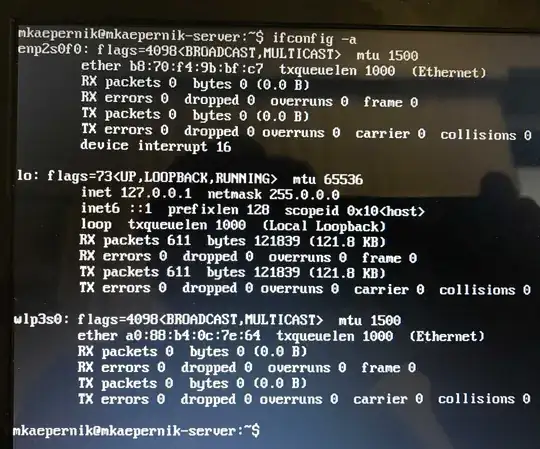

also photo from ifconfig -a

I suggest that you edit the file /etc/network/interfaces to replace the eth0 entry with wlp3s0 and add the SSID and encryption details, like this:
auto lo
iface lo inet loopback
auto wlp3s0
iface wlp3s0 inet dhcp
wpa-ssid <your_router>
wpa-psk <your_wpa_key>
So that you can ssh and ftp into it, I actually recommend a static address, not DHCP, however, let's get connected first and then proceed.
Reboot and tell us if you are connected:
ping -c3 www.ubuntu.com
EDIT:
If you wish to use ethernet as you indicated in your comments, then the sequence is:
auto lo
auto enp2s0f0
iface enp2s0f0 inet dhcp
Reboot.
