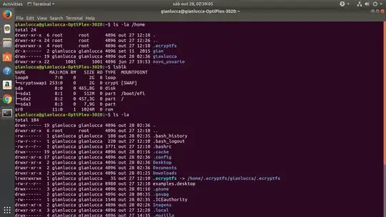

I was using Ubuntu 16.04 then I downloaded Ubuntu 17.10, put it on a bootable flash drive and installed it. During the installation the system asked me if I want to Delete everything and reinstall the system or to keep all files possible and just update the system. I chose to keep all the files and update.
Until there it was OK, but now it's already installed and I no longer have access to my files. I looked at the hard drive and it's 63% full which means that my files still are there. How can I get access to those files from my current system? or How can I get those files without an external hard drive?

your new username (and consequently home dir) is called gianlucca.
your old username and home dir (from 2015) was called gian. your files are probably there.
but i also see that some home dirs are encrypted. if it was the old one and you didn't save the recovery key, you lost it all.

There are two folders in /home location which are dated Sep-17 and Jun-17. Check if they have the data you need. Else, include results of sudo du -h -d 1 /home 2>/dev/null and sudo du -h -d 1 / 2>/dev/null. This would help determine where the 63% disk is getting consumed.
Edit: The folder location /home/.ecryptfs is showing as 294GBs. Use cd /home/.ecryptfs to access it. Use ls -la to check the content there. If it is encrypted you may not access it and would need to follow this: Access encrypted drive on separate partition
