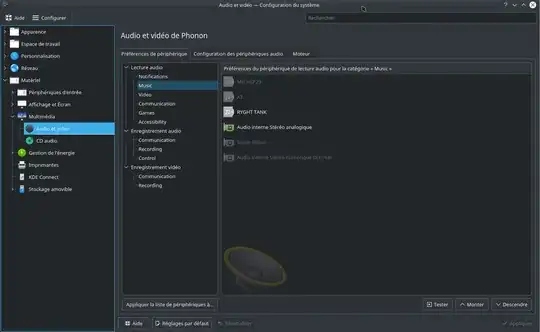

EDIT (11/05 got it!): I ended up with a solution:
sudo apt install kmix
reboot
then
sudo apt install pulseaudio-module-bluetooth
reboot
pactl load-module module-bluetooth-discover
(last command may fail)
Then remove all your saved bluetooth devices and pair them again.
Do not forget to set the bluetooth devices at the top of the list of audio configuration: Kmix configuration
