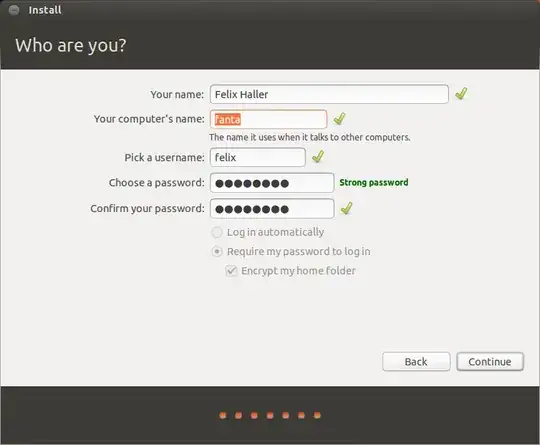

You should see a dialog as you install . Notice how the installer is recognizing your previously encypted home and the dialog to select encrypt home and automatic log in are greyed out:

Encryption options will be disabled during the reinstall process:
enter image description here Kudos to @Panther for showing me the thread about disabled encryption options in a comment below.
